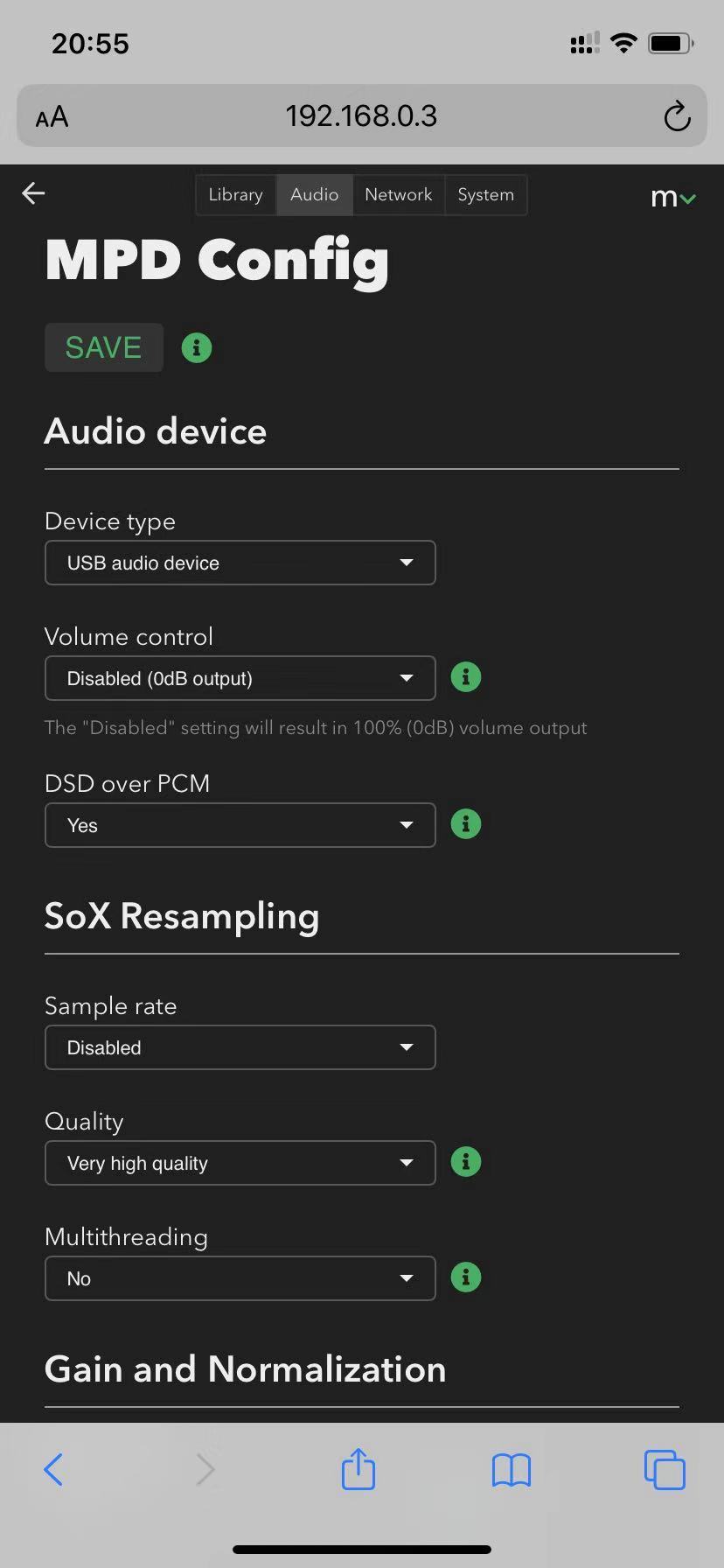

请教各位大神,
有没有使用树莓派安装moode-player接monitor 09的? 使用中碰到不能正常播放DSD文件的问题。在网上搜到moodeaudio论坛上关于这个问题的一个讨论,http://moodeaudio.org/forum/showthread. ... monitor+09 有网友咨询开发者提到一个观点:The DAC vendor has found the reason.The USB interface asic use a SOF count mechanism instead of buf point offset.SOF has poor compatibility with Linux.I don't know details about this but wonder if moode can make some change to adapt to this. 开发者回复:There isn't anything I can do in moOde software. The DAC vendor is responsible for making sure their product works with Linux.
是否有解决办法。

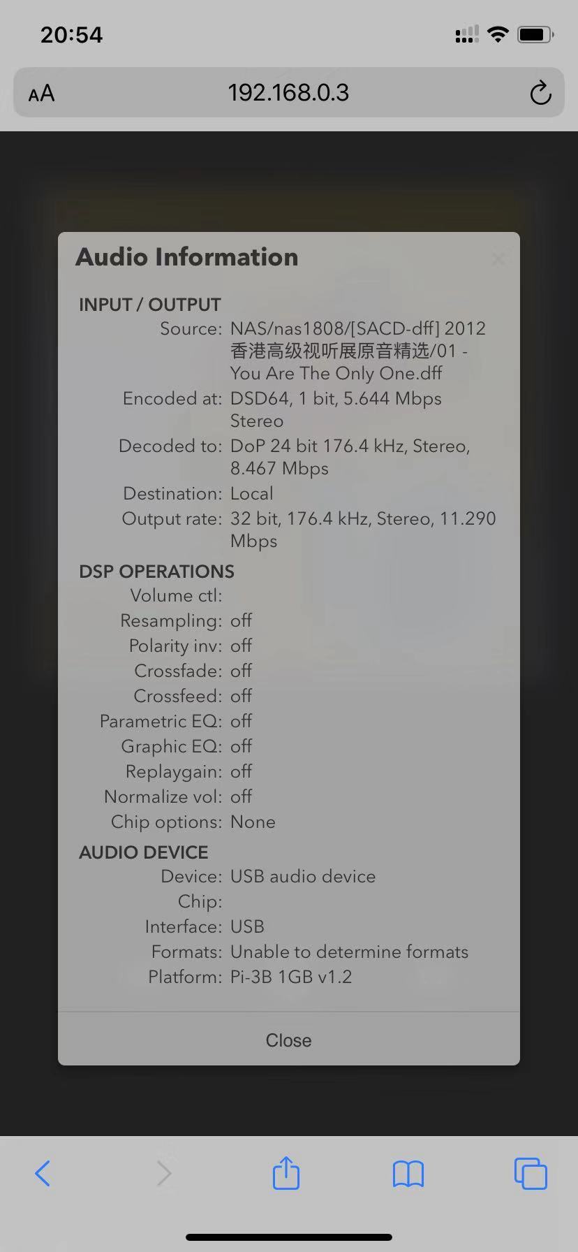

播放DSD文件时会有以下提示:
MPD error
Failed to open "ALSA default" [alsa]; Error opening ALSA device "hw:1,0"; snd_pcm_hw_params() failed: Broken pipe
